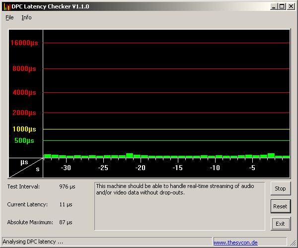

Today I just happened to install DPClat.exe on the old supposedly slow computer and noticed that it's statistics are almost identical to the new supposedly fast computer. Both computers stay focused in the green zone at about 100, indicating that dropouts should not be a problem.
However, the newer computer (GT5622) has irregular spikes into or just below the yellow about every 10-20 seconds, whereas the older computer (Select 750) doesn't! The older computer thus far is actually more reliable in this test!
I haven't yet done any recording on the old computer since I installed XP on it. But it was very stable and glitch-free when it ran Windows 98 SE optimized for audio with those same 5400 RPM hard drives.
In contrast, the new computer with Vista and with optimization tweaks has been subject to frequent stuttering-interrupted audio recordings! This newer computer also scores low in Window Experience indexes, because of the built in Intel graphics hardware. The older computer has some kind of PCI graphics card I think.
It will be interesting to see how the old computer holds up after I install the complete set of audio programs I intend to use on it. But so far, so good.

      #646232 - 13/08/08 03:09 AM
Spec from CPU-z
CPU: Pentium 4 @ 3.0 Ghz (Prescott)
MOBO: Gigabyte 81848P775-G
Chipset: 848p
Southbridge: 82801 EB
FSB: 201 MHz
Bus Speed: 803.9 MHz
1 Gig PC2700 Corsair DDR RAM
XP Pro (sp2)
Marvell Yukon Gigabit NIC
Audiophile 2496 PCI
System Drive: 80 Gig Seagate Barracuda
Media Drive: 140 Gig Hitachi Deskstar
Promise Ultra133 TX2 IDE Card with 2 more 120 Gig Seagates
2 x External USB2 250 Gig Seagate Barracudas
Low Idle: 10-14
Average: 20-40
Max: 87 (when one of the external USB drives decided to wake up)
I'm really very surprised at this what with the huge specs of some of the systems on here. The PC was originally built as a DAW but it's now used primarily as a Flash, website and Photoshop authoring workstation. I'm also running Firefox, Spyware Doctor, NIS and its host of associated background processes.
With all the talk of network adaptors slowing things down I thought I'd stream a Div-X movie across my network from the host PC and crack open my FTP software and perform a few uploads. This resulted in a higher peak of 135 and an average of around 35.
I then prompted Symantec's LiveUpdate as I know it's a really hungry process - it jumped momentarily to 195 and then calmed down again.
So it seems a higher spec system doesn't necessarily mean lower DPC timings. Groovy.
