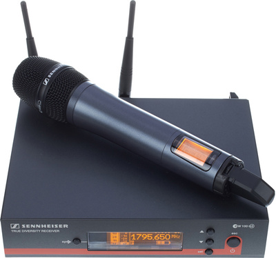

Sennheiser *do* actually have a new system working in the 1800MHz band.
This was originally set aside for digital radiomics only, but stayed empty for years because no one made digital radiomics.
Now it's been opened to analogue radiomics as well - and safety is good, I understand, as it's for radiomics only.
Details are HERE.
Unfortunately it's a licensed band in the UK - but safe as it's well away from everything else.
John - Sound-Link ProAudio
President - Federation Internationale des Chasseurs de Sons
UNMUTE
Joined: 01/02/12
Posts: 33
Re: Handheld Wireless Mics new [Re: John Willett]
      #968306 - 04/02/12 03:58 PM
Quote John Willett:
Not quite - GSM (mobiles) that do not operate on 3G still use the 900MHz and 1800MHz bands. Initially it was just Orange and T-Mobile that used this part of the spectrum (1800MHz). I believe the other two (O2 and Vodafone) also have a share of that band too.
Once the whole of the UK has switched over to digital TV, this will free-up the 800MHz band. This will be used to roll out 4G services. 3G services and possibly 4G services will probably use the 900MHz band. I believe the 1800MHz band will gradually be phased out for mobile communications.
This is a long time off though as many people still have legacy handsets and the base station equipment will need to be upgraded.
