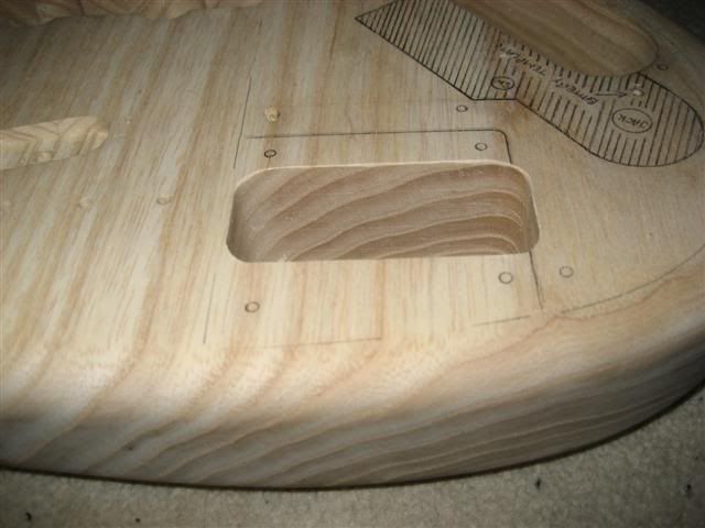

Postby Dan LB » Thu Apr 17, 2008 8:55 pm
Ok. Today I decided to do some routing. Firstly I positioned my battery template on the body and secured it with a couple of screws. I made sure to countersink the screws so the router base ran over them smoothly. I ran a straight edge over the template to make sure they were sunk deep enough.
I had my router already set up with a ball bearing routing bit that I bought from StewMac. In the picture you can see the cutting head of the bit at the bottom, then there is two ball bearing 'collars' with some plastic tubing on top. This tubing is there to stop the collars riding up the shaft while using the router.
I made sure to have the depth for the first pass set so that the first ball bearing collar was protruding from the router base when fully plunged. This collar then rides inside the template.
Dan LB
Posts: 786
Joined: Sat Jan 28, 2006 12:00 am
Location: Wicklow, Ireland
Re: Warmoth Fender Marcus Miller Jazz Bass Copy
Postby Dan LB » Thu Apr 17, 2008 9:21 pm
Ok so now I was ready to do some routing...... or so I thought.
I donned my safety goggles and a dust mask, and inserted my custom moulded earplugs ( I had to use these as I have no other ear defenders). ALL OF THESE SAFETY ITEMS ARE ESSENTIAL!!! DO NOT ATTEMPT TO DO ANY ROUTING WITHOUT WEARING THE PROPER SAFETY EQUIPMENT!
So I plunged the router into the body and proceed to make the cut. All was going well until the bit started to cut into the template!!!! SH1TE! I didn't have the plunge lock engaged and I let the router raise up a little by accident.
I realised what was happening quite quickly and shut the power off.
I was able to complete the routing in several passes, albeit with a now misshaped template. When I finished, It looked pretty bad.
I then had the idea to clean up the template with my Dremel and go over the existing rout. The finished result is not perfect but I'm pretty happy with it. Bear in mind this is the first time I've done any routing!
As you can see, the battery compartment will now run under the control plate slightly, but I'm not too concerned as it will all be covered up. The inside of the battery rout will be lined with sticky-backed foam to stop the battery knocking around inside.
So let this post be a lesson to those of you that intend on doing any routing!! I'd recommend making some test cuts on some scrap wood before you start.

Postby Dan LB » Mon Apr 21, 2008 7:04 pm
I've put 1 coat of black stain on the body and it's already close to what I'm looking for. I'll post photo's when I've done the second coat and it has dried.
In the mean time I mounted most of the electronic components into the control plate. I made sure to remove the plastic protecting film from it first because I hate trying to remove it from around pots etc later. I'm sure you will have experienced this at some stage if you ever owned a Strat from new! :lol: Some people prefer to leave it on if they intend to resell the instrument, but I find it'll just start to peel off anyway.
As you can see from the photo, the back of the control plate had already been covered with conductive foil.
I've also installed the knobs on the pot shafts. The two metal knobs are Vol / Vol, and the plastic jazz bass knobs are Bass / Treble.
The switch will be EQ on/off.
I made sure that the two volume knobs point in the same direction when fully turned up, and that the two EQ knobs point in the same direction when at their centre detents.
I'll mount the Aguilar preamp to the control plate with some sticky backed velcro. Now it's time to fire up the soldering iron and start wiring this puppy up.
