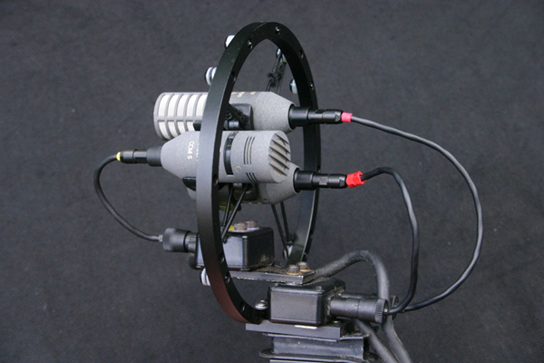

The closest equivalent of the Jecklin disc is probably the Schoeps KFM360:
