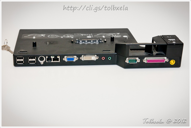

Well another update to say I now own an additional z61p along with a 2504 docking station (FRU 42W8298)and SATA Ultrabay caddy (FRU 26R9246). This z61p is in mint condition and so are the other items and I got them all together for a very good price. So I will probably upgrade the CPU on this one to a Core 2 Duo T7600 as well and the RAM from 2GB to 3GB.
*** Click on photo below for a larger view (not my photos but they are the same models ***
