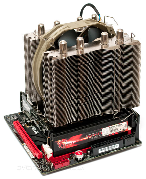

My latest build (Intel 4771) uses a Noctua NH-U14S CPU cooler which being PWM is speed controlled by the motherboard. The fitting of the cooler was a doddle - only problem is it is an enormous device, gives the impression of a cooler with a mobo attached rather than the other way round! As a consequence on my board - Asus H87 - the RAM slot closest to the fan is blocked except for low profile memory. The only other fan I have in the case is the one in the Seasonic X series SS-650 KM fully modular PSU. No problems so far and I am very happy with the absence of noise - the main drive being SSD.
Dave

Postby Pete Kaine » Tue Aug 19, 2014 9:21 am
Taken to the extreme Dave.

Pete Kaine wrote:Taken to the extreme Dave.
Offramper
Posts: 57
Joined: Sun Apr 30, 2006 11:00 pm
