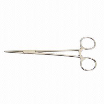

Postby shufflebeat » Mon Apr 17, 2017 6:15 pm
I can't remember why I bought them but I've found a little scissor clamp to be really useful, not only for picking up and holding tiny things in hot places but also in preventing heat going places you don't​ want it.

Postby Trevor Johnson » Tue Apr 18, 2017 5:35 pm
They are (Halstead) Mosquito artery forceps and are widely available.
