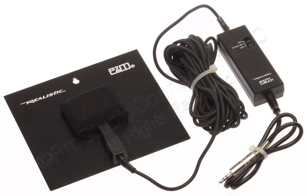

I was looking at a pic of the much-respected (and modded!) Tandy PZMs last night and was reminded that they incorporate an arrangement for fastening them vertically...

Am I missing something (I had a couple back in the day) but, if memory serves, the vertical mounting device consisted of a hole in the backplate to hang them on a nail? :sick:

Postby Music Wolf » Fri Nov 30, 2018 1:50 pm
That's how I remember them

Postby forumuser915213 » Fri Nov 30, 2018 2:26 pm
That's what I remember too.
