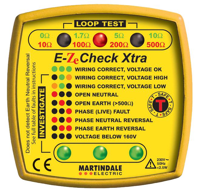

ef37a wrote:You could also throw a Martindale socket tester into the mix, whole lot should set you back no more than 30quid.
The standard tester is a life saver, for sure, but I prefer this slightly more expensive version as it gives a really useful indication of the actual safety ground impedance, rather than just whether or not there's a connection.
https://cpc.farnell.com/martindale-electric/ez150/earth-loop-socket-tester-no-trip/dp/IN04254?st=mains%20socket%20tester
