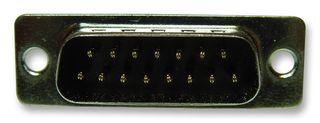

I cant find a 15pin D-Sub going to an RCA.Well, to be accurate, I cant find a D-SUB with pins in 2 rows. The only connector I can find which might fit the bill has 15 pins but they are arranged in 3 stacks of five. So that wont work.
You're describing the HD version. You want a standard 15-way D-sub like this:
https://cpc.farnell.com/starconn-connectors/ds-15p/d-plug-15-pin-solder/dp/CN00800
