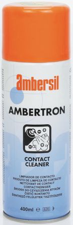

Postby Dan LB » Thu Jun 11, 2020 6:22 pm
blinddrew wrote:I assume a generic maplin switch cleaner will do the job?
Yep, should do. :thumbup:
I use Ambersil Ambertron for general contact cleaning duties.
Readily available from Radionics.
