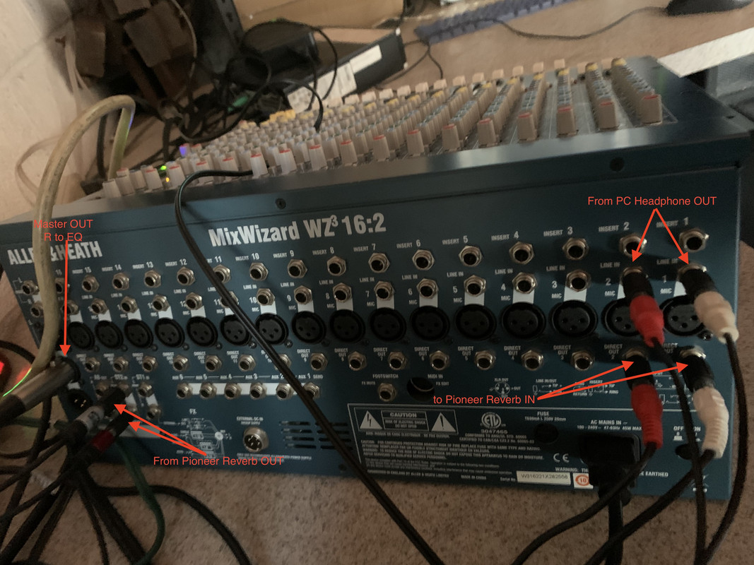

Hey guys, I got my son's Allen and Heath Mixwizard 3 this morning but can anyone tell me the best way to connect the Input and Output from the Lexicon to the Mixwiz 3 please?
https://i.postimg.cc/9fhhwY01/mixwiz.jpg
https://i.postimg.cc/4d2qP6fD/Screen-Sh ... -16-AM.png
How do I connect Lexicon M200 to Mixwizard 3?

Ok guys, appreciate the help and please bear with me as I am new to mixing boards. I am trying to soak in all of this unfamiliar terminology.
Since I have only one stack of speakers bass, mid and highs on a tri-amp config and have been running only my DJ Mixer's R Output into the EQ, I have connected the M jack of the Mixwiz to the EQ and the PC's OUT to Line 1 and 2, all is fine with the sound and power.
I have to say that yes the Mixwiz's sound is a little better right now than the DJ Xone23 mixer, might get even better after my bud comes on the w/e to optimize the entire system.
Now to the main deal, getting my Lexicon and Pioneer Reverb SR303 to work effectively on the Mixwiz.
So I connected the Aux and Line IN on Channel 1 on the mixwiz to the OUT L and R on the Lexicon and the INPUT on the Lexicon L and R to the Insert L and R on the mixwiz. Now I can hardly hear any music. I have the Lexicon's Input knob at Unity and even if I turn it all the way up still the issue. I have the Mix Knob set fully to Wet.
What am I doing wrong please? Also, please note I am using mono 1/4" unbalanced adapters on RCA'S for now but this wasn't an issue when the fx units was connected to the Xone 23.

The laptop's headphone OUT [3.5mm] to the Line IN on channel 1 and 2.
So I set the Direct OUT 1 and 2 to the Pioneer IN and it''s OUT back to ST2 and it's working now. in a little while will try the ST 1 for the Lexicon, will report back.

This might explain what I have done in a better way guys.
So Mixwiz Master OUT to EQ In, EQ OUT to Rane IN, that's pretty much it.
