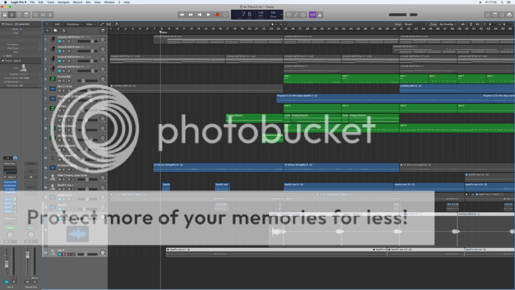

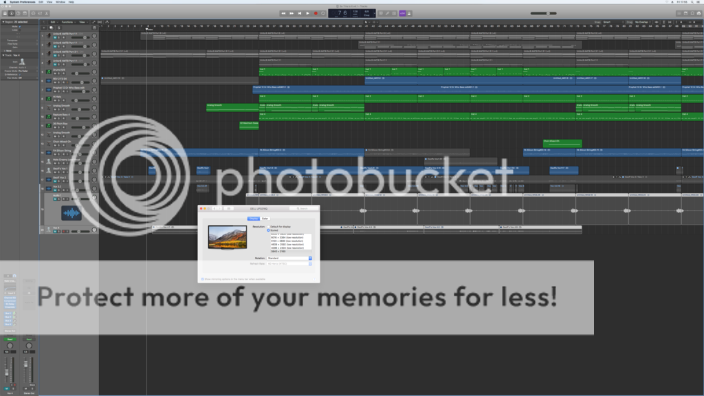

I do use the native resolution of 3840 x 2160 when using Logic because it displays so much more info (see images).
It helps too that most of Logic's plugin windows can now be resized to a large enough size to be easily viewed at higher resolutions.
For those 3rd party plugins that don't increase the UI size I use the 'zoom' feature built into Mac OS itself as a workaround, but the higher resolution , particularly when mixing is a God send.
