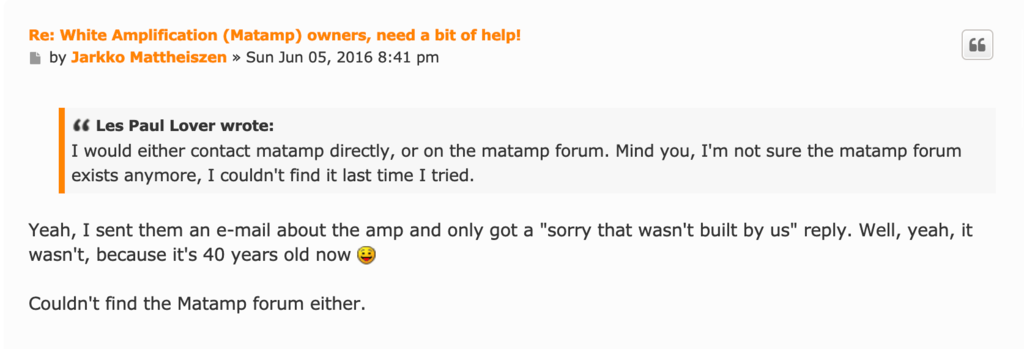

I've certainly found that exact issue with larger companies, especially with old equipment. While not music related I'm currently going through a bit of a slog with JVC about some 7 year old TV cameras we use at work. No contact email or phone number at all on their website, just a form. 2 weeks later and still no response. Hey ho.
This is what a poster on another forum got in regards to emailing Matamp, at least they got a reply I guess:
