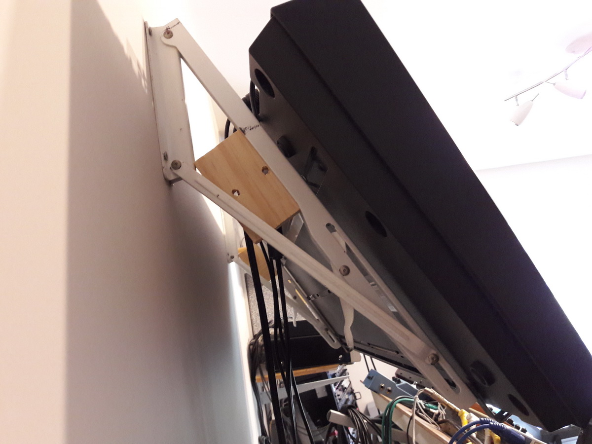

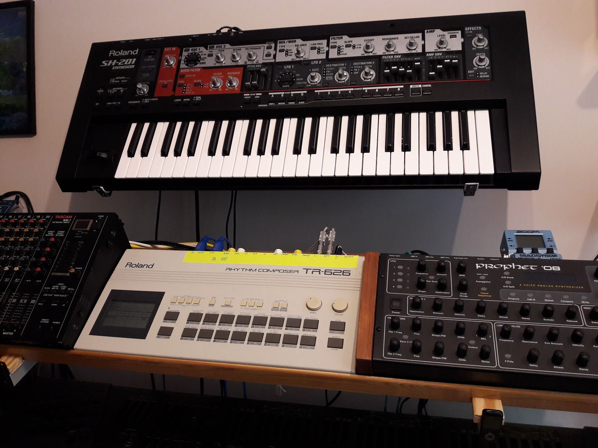

Most of my keyboard racking is standard dual-tier plus 1 triple-tier.
blinddrew wrote:Something like this might do the job though: https://www.amazon.co.uk/YUYUE21-thick- ... 76&sr=1-21
That's pretty much what I did to mount my (fairly lightweight) SH-201 above the triple-tier rack:
The adjustable brackets were 'fixed' at the right angle by placing just the right sized wooden block:

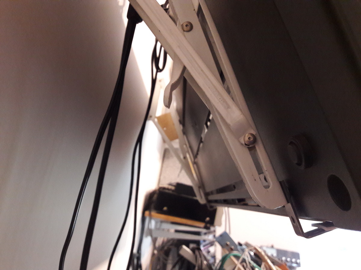

As there is no nice bracket at the bottom to to stop the keyboard sliding off, I then had to improvise by bolting on an angle bracket (with sticky-back foam to prevent scratching):

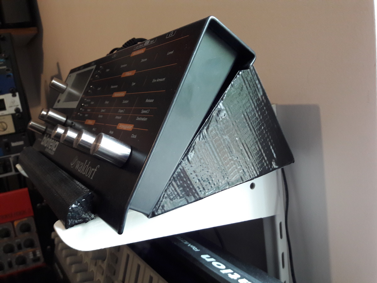

Elsewhere I have used ordinary shelving brackets with angled fillers made from corrugated cardboard and gaffer tape, and end stops from quarter-section dowel and gaffer tape:
That's the Blue Peter generation for you :bouncy:

I have angled slot brackets for a couple of synths
https://www.ebay.co.uk/itm/201464263898
I had to add a little corner bracket to the ends to prevent anything sliding off (similar to one in BillBs picture)
