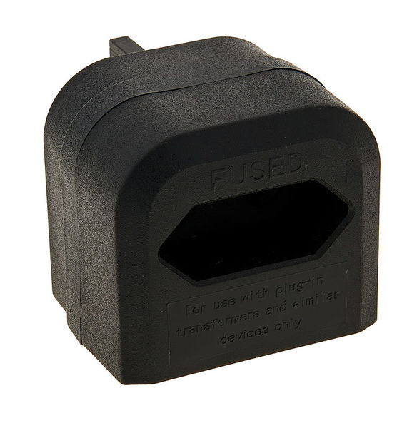

A simple plug-in travel adapter is not legally acceptable!
This is the typical thing supplied. Theres a fuse in the back.

Which is what I'm referring to. I'm not aware of any other kind.Hugh Robjohns wrote:A simple plug-in travel adapter is not legally acceptable!
Correction gratefully accepted. :thumbup:
The last time I bought a PSU-cursed item from Thomann it came with a cheap, brittle white plastic EU-to-UK travel adapter. It certainly looked nothing like the black one above (which looks much better - never seen one of those). The whole delivery went back in short order! The adapter looked pretty much (including label) identical to this:
Which still begs the question as to how 'Thomann UK' can (or feel they can) get away with it. But not with me they aren't. :protest:

That kind of simple travel adapter is illegal to supply for use with new equipment in the UK and it should be reported to Trading Standards.
The legal adapter looks something like this:
The EU plug is held captive, there's a 5 amp fuse in the live side, and the lid is secured with a screw (ie the adapter can only be opened with a screwdriver tool!)
Obviously, this kind of adapter can only be used with plugs on cables. It can't be used with wall-wart power units...
For wall warts with integrated EU plugs, the only viable solution is the nasty travel adapter you illustrated, but that would technically be illegal to sell as a solution with new products sold into the UK.
