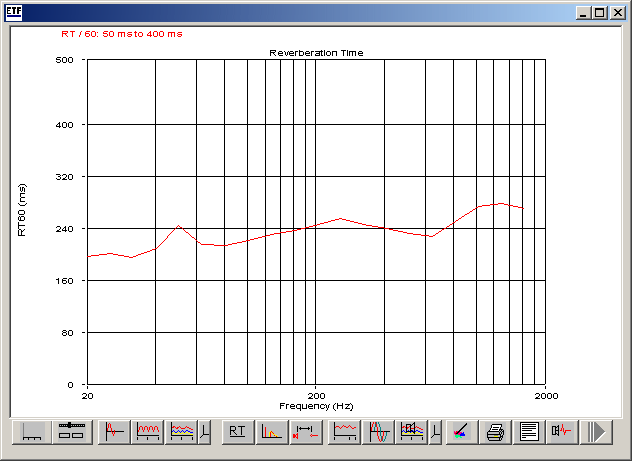

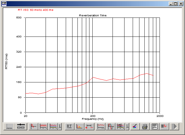

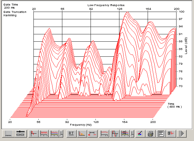

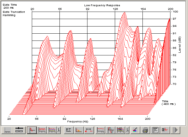

Thanks for your reasonable and calm response. Now, with the following graphs we can all put to rest the notion that MiniTraps are tuned or narrow band. I'm hoping that with this data you and Paul will finally "get it" when you see these measurements that clearly show broadband improvement after adding RealTraps to a room.
The two "waterfall" graphs below show the modal ringing in the RealTraps lab - a 16 by 11-1/2 by 8 foot room - empty (top) and with traps (bottom):
The next two graphs show the RT60 of the room empty, then trapped. The frequency extends to 1.6 KHz which I'm sure we all agree is well past the bass range. As you can see, the reduction in RT60 is quite consistent all the way up to the 1600 Hz cutoff:
I know it looks to you guys like a MiniTrap is tuned, but it really isn't. Here's the data from our site to refresh everyone's memory:
We all agree that the peak around 100 Hz is mainly related to corner mounting. Then, somewhat above there, the absorption falls and levels off to the 10 KHz data limit. Just as important here is the difference between the frequency of maximum absorption versus the range of effective absorption. 8 Sabins is a lot of absorption, and both MiniTraps and MondoTraps exceed that to well past 1 KHz. Again, remember that 8 Sabins of absorption from a panel having 8 square feet of front surface is 100 percent absorption. So to criticize a MiniTrap as ineffective above the mid-bass range is simply incorrect.
