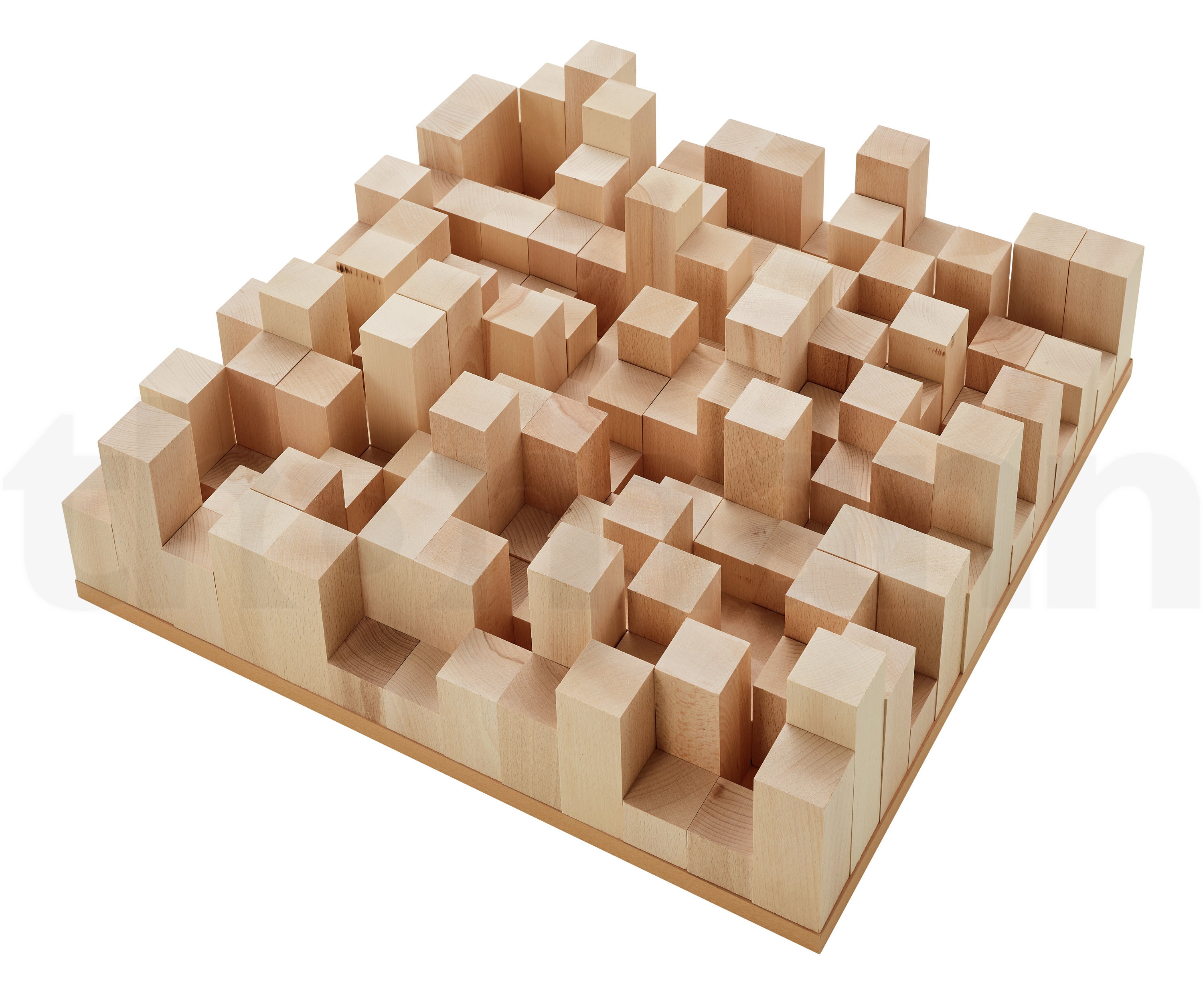

Btw, diffusers tend to look like these (there's also other forms but these are common)
They are useful for higher frequency ringing, and are nice to look at, but be aware, massive wood ones weight a lot. I had 6 made for my wall, but wasn't aware each 55x55 panel was 16Kg... I even bought super heavy duty anchors from the US before looking at my drywall and thinking "nah". So I resold them.
