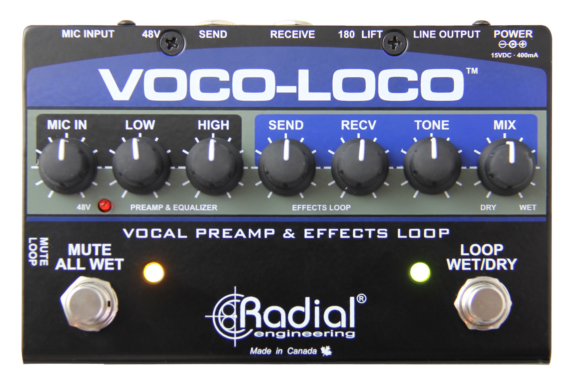

I recommend the Radial Vocoloco for this application:
https://www.radialeng.com/product/voco-loco
You can use any (guitar type) stomp box with your microphone.
