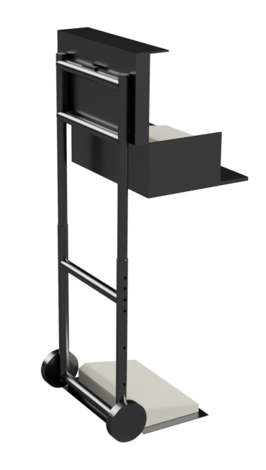

However, the big struggle I'm facing now is how I can deal with the physical form factor or 'structure' of this rig, which will hold the gear and allow it to be both transported and used as a workstation. Here are the key components of the structure I'm trying to figure out:
  • A frame, with wheels, that can be collapsed down for transport but also used directly as a live performance station, and
  • Case(s) to house the gear, which can mount to the frame at the correct height for performance:
  • Upper case which can be opened up to work with during performance, but also be transported independently of the frame. Doesn't need a ton of protection- will not be a flight case, just in my car. If possible, I'd like it to have a separate compartment for the power supplies and any miscellaneous cables.
  • Lower case for the foot controller. Again, can mount to the frame or be transported separately.

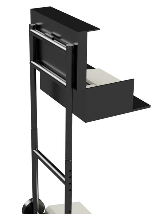

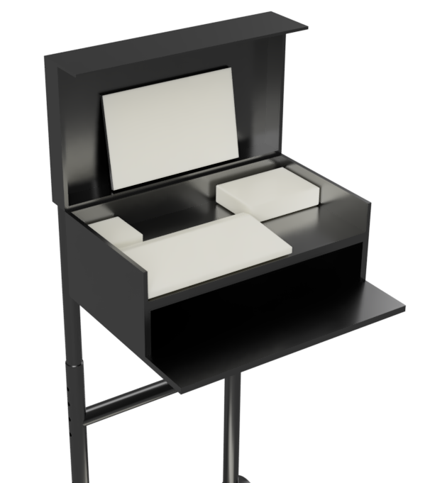

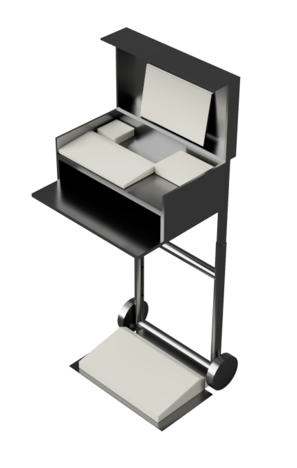

Here's a CAD drawing that includes the basic components and the frame/case concept I've outlined for visual reference:
ImageImage Image Image
(The items in white are the gear I listed above, to correct scale, but the frame/cases are not necessarily exact in any way- because they don't exist yet! Just a visual aid.)
So, what I'm really looking for help with is if anyone knows how I can actually build or get a frame / cases that can serve as the infrastructure to put together the gear as outlined, and be used for portable and performance purposes? (A lot of p's, that's for sure)
A couple other considerations for this part would be that I'd also like to be able to have the frame extend taller or shorter depending on if I'm sitting or standing when using it, and it can collapse for portability in the trunk of my hatchback. Furthermore, I'd plan on having a 'shelf' (not pictured) just above the foot control section that my Alto Music PA could sit on if the location doesn't have a house PA.
Again, if anyone has any ideas on how to build or piece together a frame that can satisfy these general constraints, as well as how to find or make a working gear case that satisfies for the gear housing purposes outlined above, please drop it down below!

The most obvious challenge with your draft design is stability because it appears that there's potentially a lot of weight high up.

Hugh Robjohns wrote:The most obvious challenge with your draft design is stability because it appears that there's potentially a lot of weight high up.
Hugh has a good point there, it looks way too unstable.
If you’re handy with wood you can knock something up in no time, and use heavy timber for the base, there are places that do various wheels and fittings for those who make home made cases/racks etc. Slosh a load of matt black paint on it and you’re done.

Agree with the others. I'd suggest putting everything except the touch screen on a shelf just above the pedals.
Keep the top platform as protection for the screen when closed, and also a place for a pen, notepad and merchandise.

Yes, for clarification- this is by no means a precise design drawing. Merely meant to illuminate the concept I've got up in the brain :)
I'm leaning towards some sort of metal piping system with connectors if I have to build completely from scratch, for aesthetic and structural reasons over wood. I think there might be a few DIY systems with connectors to help with this, but have to do a little more research.
Do you have any links/examples to wheels and fittings, and custom made cases? The cases is definitely something I'm unsure about at this point.

Computer definitely, interface yes unless you need to frequently reach it, keyboard probably not - didn't know you'd be using one.
The reason is mostly to get the weight as low as possible for best stability, but also to reduce clutter in your working area.

Here are the weights and dimensions of the objects pictured on the upper case:
Computer (Intel NUC) - Weight: 2.5lb - Dimensions 4.4 x 4.6 x 1.4in
Interface (Saffire 8i6, with PSU) - Weight: 2.4lb - Dimensions 8.27 x 5.89 x 1.87in
MIDI controller (M-Audio Axiom AIR Mini 32) - Weight: 2.5lb - Dimensions 15.6 x 7.7 x 1.5in
Touchscreen - Weight: 3lb - Dimensions 14.45 x 9.13 x 0.4in
So, interestedly each have very similar weights which are also fairly low, all four of these components totaling 10.4lbs. If I include a plastic power strip in the upper case, let's say that's an extra 2lbs. The question is if I can build a case fairly light to deal with the weight balance. I believe the Helix LT at the feet is around 15lb.
I may also purchase a small keyboard/trackpad, which I think could actually rest on top of the NUC and Saffire side by side, to save real estate if they're in a smaller case side-by-side - the tops of these devices aren't used anyhow!
The big question though is, how will I mount these devices to the case so they stay put during transport? They all have Kensington Lock ports, so maybe there's a way to hard-mount them into the case using those as anchor points?
