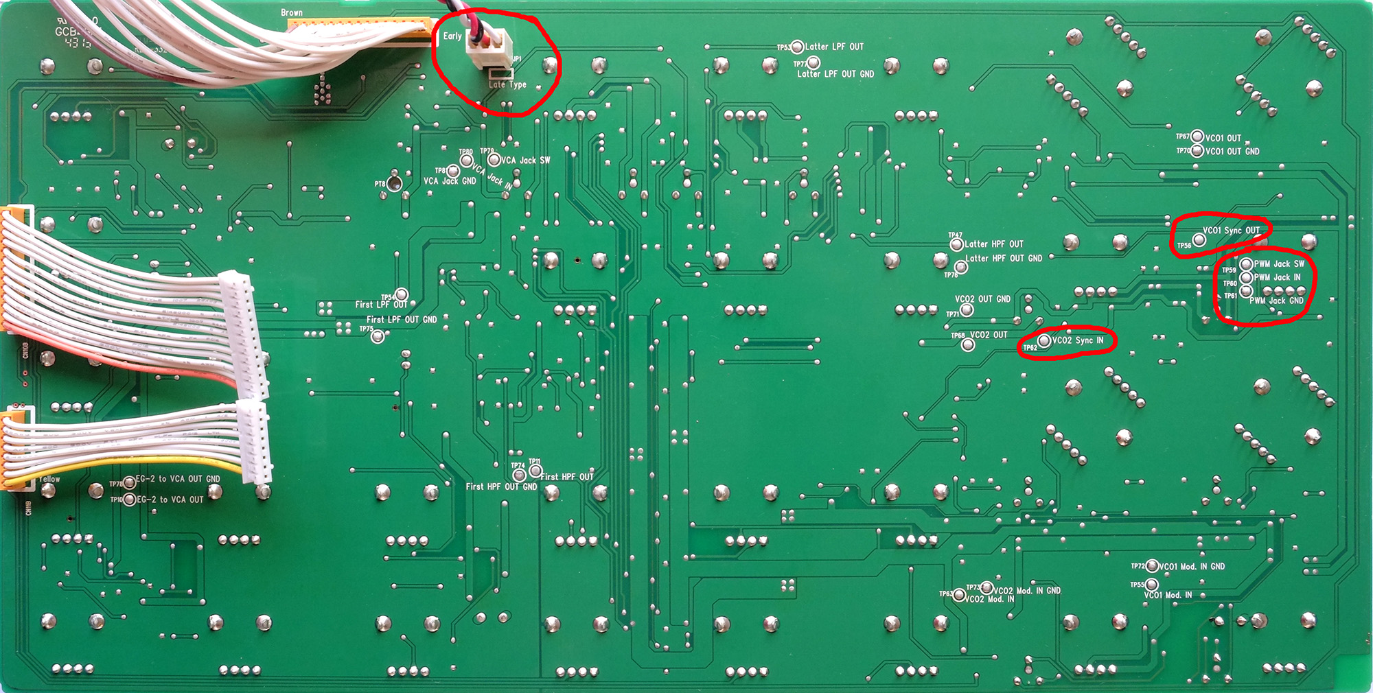

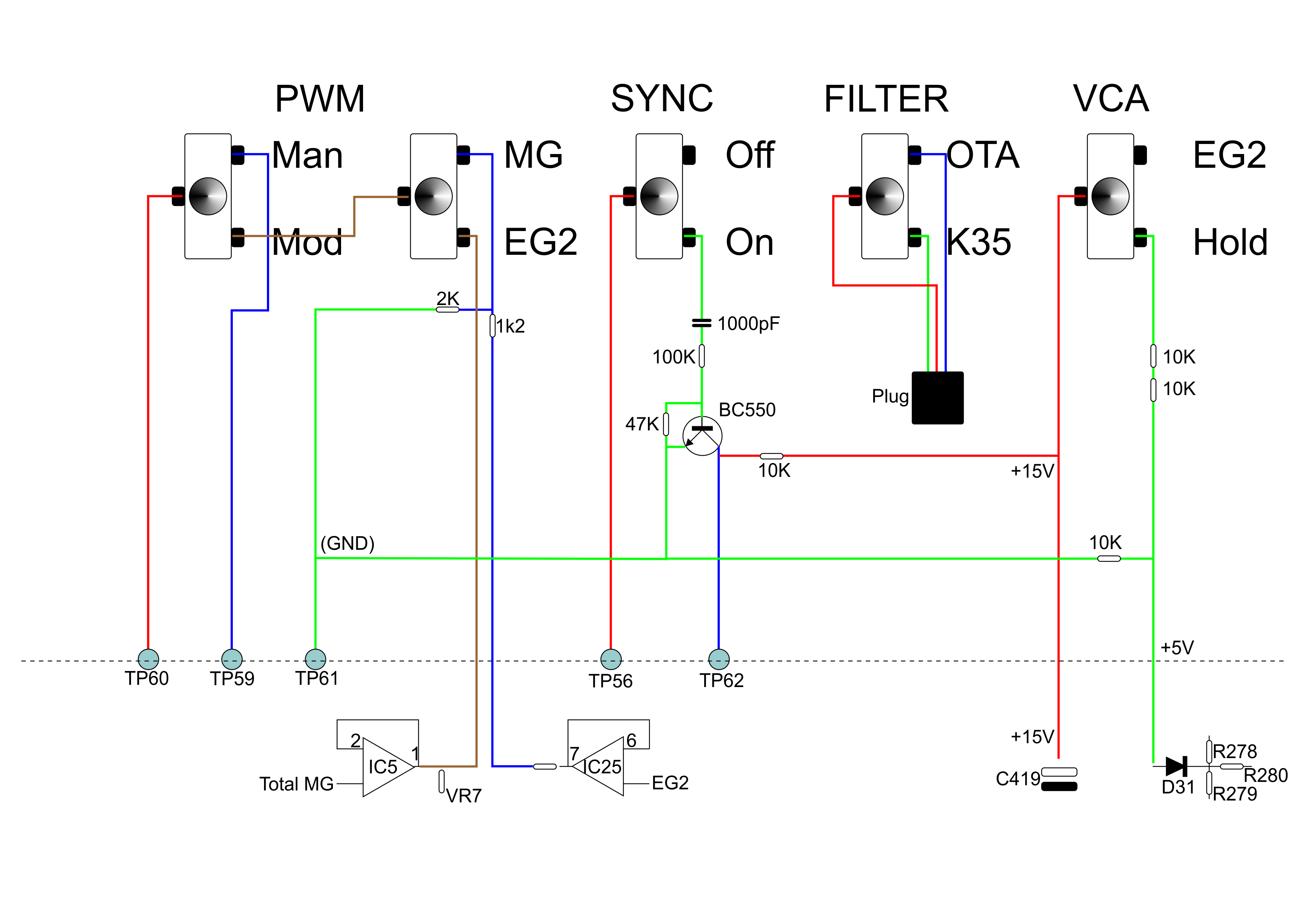

Just a quick update on the MS20 Kit modifications I discussed earlier. Managed to finish the mods and put the whole thing together today. Everything working as expected/wanted.
Here's a schematic of the mods I've introduced:
Most of it is very obvious and straightforward.

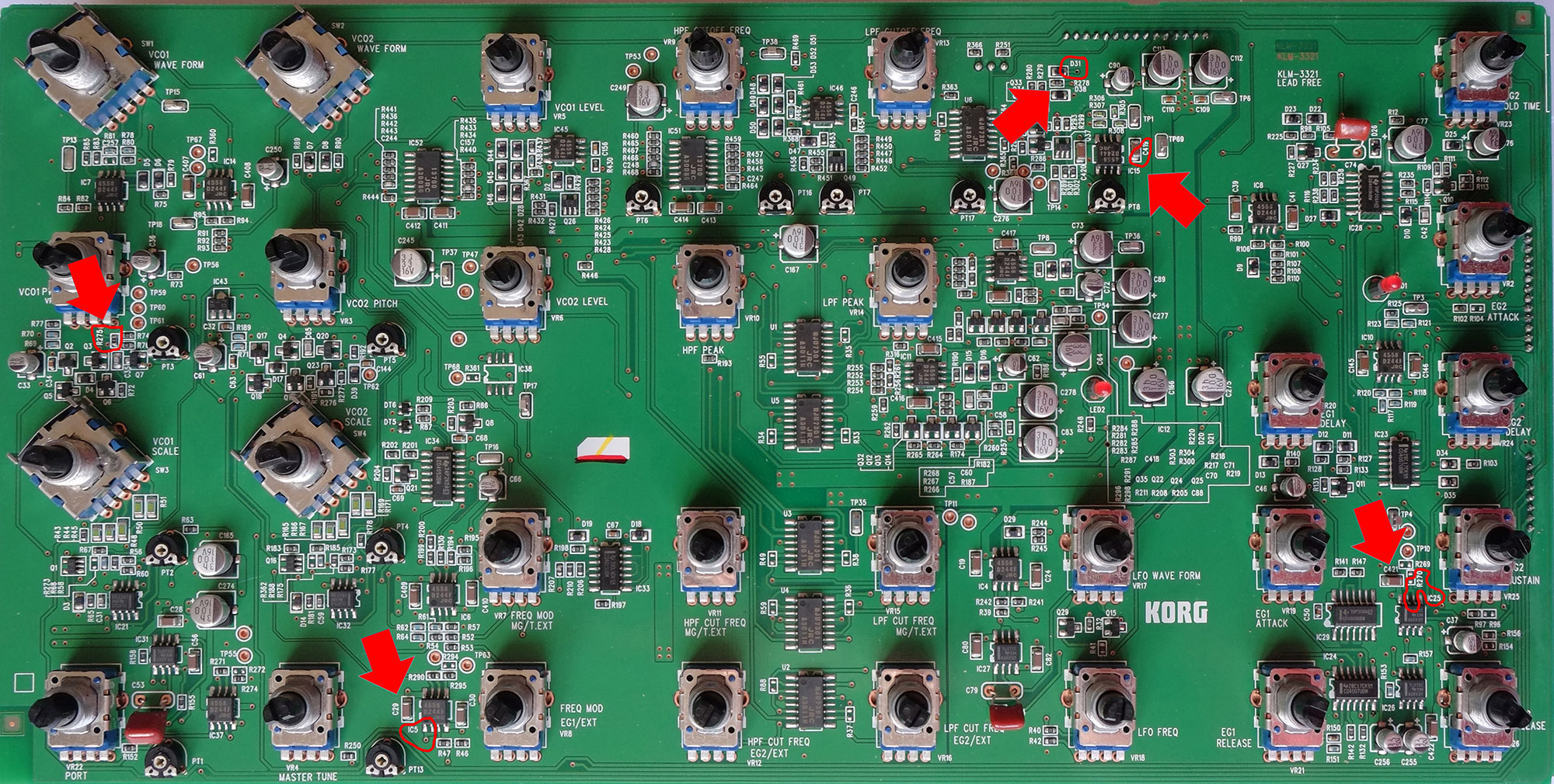

PWM -- I have two switches, the first selects normal or modulated, and the second the modulation source, which is either the LFO (MG) or the second Envelope Generator. The LFO source comes from IC5 pins 1/2 (bottom left of main board), while the EG2 source comes from IC25 pins 6/7 (bottom right). The EG signal is attenuated slightly to make it the right voltage range.
The connection points are the marked pads on the rear of the main board (see below) The only modification required to the board is to remove a '0 Ohm resistor' (R275) just under the PWM pot (see image below). I simply cut it in half with cutters, and unsoldered the remaining bits! This resistor is there to provide a link between TP59 (marked jack switch, which is connected through a resistor to the 15V supply) and TP60 (marked jack in connected through a resistor to the PWM pot), and it needs to be removed to allows effective external PWM control. The switch effectively restores the 0 Ohm link in its normal position.
Of course, if you wanted an PWM control input socket instead of the selectable MG/EG2 that I wanted, you could simply wire a TS socket (with normalling contact) to the three pads. TP59 goes to the normalling contact, TP60 to the tip contact, and TP61 to the sleeve contact -- but you'll still need to remove the 0 Ohm resistor R275.
SYNC ON -- the Sync mode requires a little extra circuitry if you want to make use of the oscillator circuit buffering that's already on the board -- as opposed to the simple diode link referred to above. It's just a simple inverter built around one transistor.
TP56 (VCO1 sync out) connects through the switch to the base of an NPN transistor (I used a BC550) via a 1000pf ceramic cap and a 100K resistor. The base is coupled to the grounded emitter via a 47K resistor and the collector to the +15V supply via a 10K resistor. The inverted output from the collector is returned to TP62 (VCO2 Sync In). I derived the +15V supply from the lower side of capacitor C419 which is near the top right, just below the connecting loom on the top edge of the main board.
VCA HOLD -- This +15V supply was also fed via a switch and a potential divider (comprising two 10Ks in the top leg and one more 10K in the lower leg to ground) to the anode of D31 which is a control input to the VCA. D31 is just above and to the left of C419. The VCA requires 5V to be fully open, hence the potential divider! When activated the VCA stays fully open regardless of the EG2 settings. I find it useful when setting up a sound or processing an external sound, instead of holding a key down!
The only other mod was to borrow the three-pin header plug from a redundant computer fan and connect that to a switch to select the two filter modes.
The circuitry and wiring was all built on veroboard and mounted on the back of the switches which I fitted to the top surface of the front panel, aligned with the control sections they affect.
Hope that helps anyone else interested in tweaking their MS20 KIt.
I can't say how these mods relate to the MS20 MINI I'm afraid, but I expect the circuitry is very similar. The sync circuitry is essentially the same as that in the MS20M kit (keyboard-less desktop version).
Needless to say, any mods are undertaken entirely at your own risk. The mods as described work for me, but I can't guarantee they'll work for you! ;)
