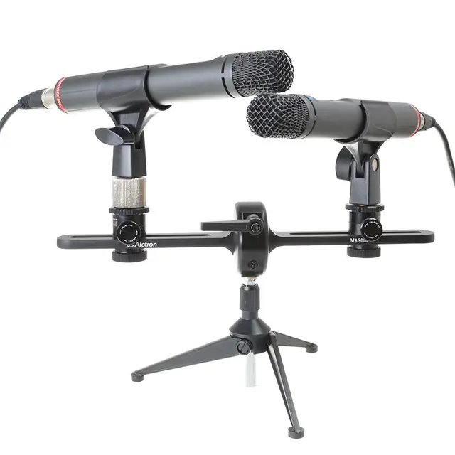

2a. I'd like to buy an extention rail on my mic stand so I can put 2 mics on 1 stand. For spaced pair (is that called AB?), what miminum distance is necessairy? These rails are limited to 217 and 200 milimeters. Isn't 217 the exact distance for ORTF?
2b, I have found 2 examples (see links below): one has 2 sides that you can change the angle by turning. The other has a system where you can change the distance by gliding over a rail (sorry for the lack of better explanation). Which one would be best to buy, considering I'd like to be able in the future to experiment with all the stereo micing techniques? And of course, is the distance big enough for spaced pair?

K&M make much longer stereo bars than that -- I have one that is 80cm long -- but even on a shorter one you can achieve somewhat wider spacings by angling the mics outwards. In any case the distance between the capsules in ORTF should be 170mm so that will be fine. You might need greater separation for spaced omnis.
Guitarking wrote:2b, I have found 2 examples (see links below): one has 2 sides that you can change the angle by turning. The other has a system where you can change the distance by gliding over a rail (sorry for the lack of better explanation). Which one would be best to buy, considering I'd like to be able in the future to experiment with all the stereo micing techniques? And of course, is the distance big enough for spaced pair?
I've only ever used the 'rail' type, but the other should be fine also. As mentioned above, the distance will be fine for ORTF, but there are some circumstances where you might want a wider spacing for AB omnis.
It's called a 'stereo bar', and there are countless variations available on that theme. I like the K&M ones, but there are plenty to choose from.

Mostly covered, but here's a couple of links to microphone bars with greater separation: https://www.thomann.de/gb/km_23560_stereo_bar.htm and https://www.thomann.de/gb/km_23600.htm.

Btw bought a 20cm stereo bar. For now should be enough. If i succed and want to do bigger ensembles i might consider a bigger bar for spaced omnis

Guitarking wrote:Read that the distance of the mics to the source shouldnt be too small when using ortf. Could anyone give me a guideline?
The guideline is that the SRA for an ORTF array is about 96 degrees, so it needs to be far enough away that the choir fits into that chord angle as measured from the mic. As previously described...
I also understand nos is for greater distance betweensource and mic?
The SRA for the NOS array is narrower, at about 80 degrees, so yes, it would need to be further away for the same choir stereo image width.
It's a bit like camera lenses. If you switch to a longer lens with a narrower field of view, you have to move further away to keep everything in the frame (and vice versa). And just like camera lenses, changing the shooting distance changes the perspective... The acoustic perspective, meaning how reverberant (or dry) the recording is.
Coincident (XY) cardioids are a bit like a fish-eye lens, coincident hyper-cardioids and ORTF are more like a 100mm lens, and NOS leans more towards a 135mm lens... (I've made those numbers up, and the actual viewing angles for camera lenses are much narrower, but hopefully you get the idea...)
Does it matter in ortf to have the mics in a sort of xy setup or next to each other pointing out ?
All that matters is that the diaphragms are spaced 17cm apart, and the mics are each pointing away from the centre line by 55 degrees. How you get them there is down to you, and will depend to some extent on he physical length of the mics and your mounting mechanics.
