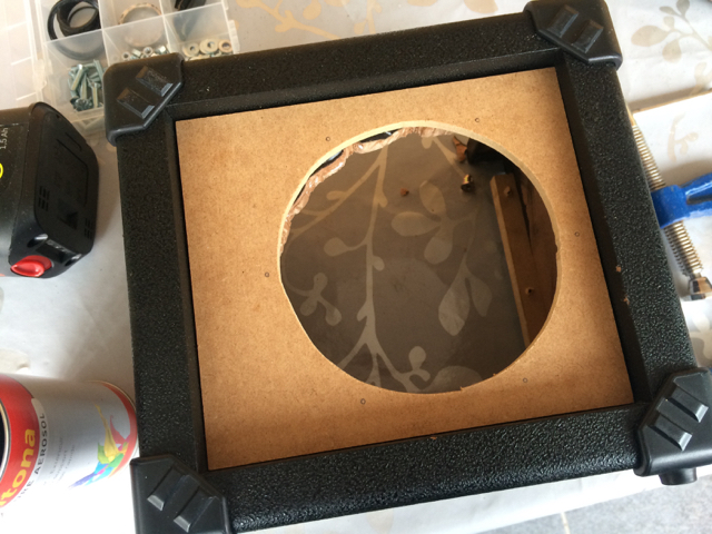

The original speaker was mounted on the outside of the baffle; I mounted the new one on the inside (there's slightly more space), resulting in a small reduction in cabinet volume, and it also partly covered the (small) port - I would expect both of these things to result in less bottom end rather than more, but I don't think that's a major factor here.
I've gathered that tweeters are not really a good idea - I can see it getting easily out of balance and sounding too scratchy, so a full-range speaker would be a better bet.
Full-ish range 6" 4Ω speakers are not that plentiful, but I found Dayton Audio's RS150 models which are reasonably priced. They make two options with paper or aluminium cones. The paper cone seems to have much less top end on their spec sheet, but says it's good for 10KHz. The alu one says 4KHz, despite its freq graph looking better at the high end. Which do you think would work better? Both look much smoother in the midrange than the Jensen too - the aim here is reproduction of the models rather than have the speaker add its own opinion!
So I think this Jensen will be going back to Thomann; I don't really have the option to revert to the original as I have of course made a bigger hole in the cabinet.

The Jensen is too large to fit on the outside of the baffle; the structure of the cabinet is such that the front of the baffle is slightly smaller than the back (inside), there being a lip around it on the outside. I enlarged the speaker hole (which is quite difficult as the MDF is surprisingly tough and the external lip gets in the way so you can't use a jigsaw on it) and then mounted the speaker on the back - all of the cone is visible from the outside. The Dayton speakers are actually a bit smaller - the Jensen is really 6.5" rather than 6" - so I think I will make an overlay for the baffle and mount the smaller Dayton speaker on the outside, which will be much neater, deal with the now-too-big hole, and also allow more room for the deeper driver. The mounting holes are fine - I was able to redrill them appropriately and re-use the Roland bushes for the mounting bolts.

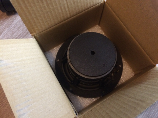

The Dayton speaker is very nicely made. The cone is quite a lot smaller than the surround, but it's still bigger and generally heftier than the original. The exact model number is RP150P-4A, which means roughly reference range, 150mm, paper cone, 4Ω, and I don't know what the A means - it seems to be a new model though, distinct from an earlier "P-4" model. The paper cone version is rated up to 10KHz, considerably higher than the plastic version. The centre pointy bit remains stationary and the cone moves around it.

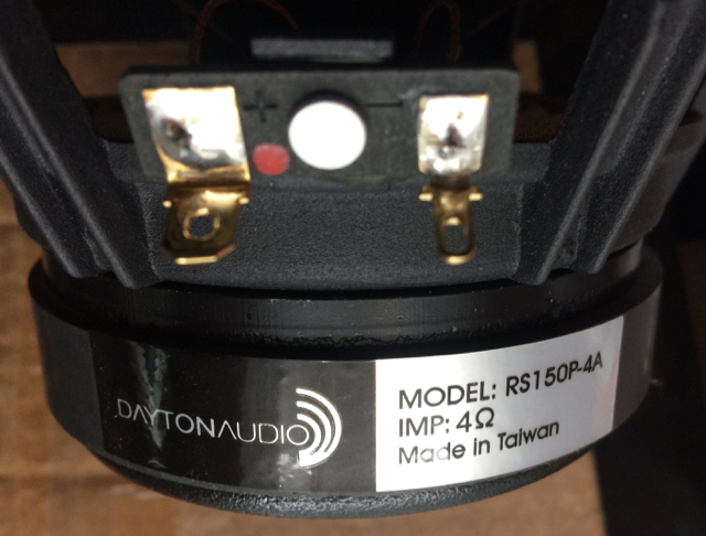

Gold-plated terminals, though they are are slightly smaller than the original, and I had to crimp the connectors a little to make them fit tightly:

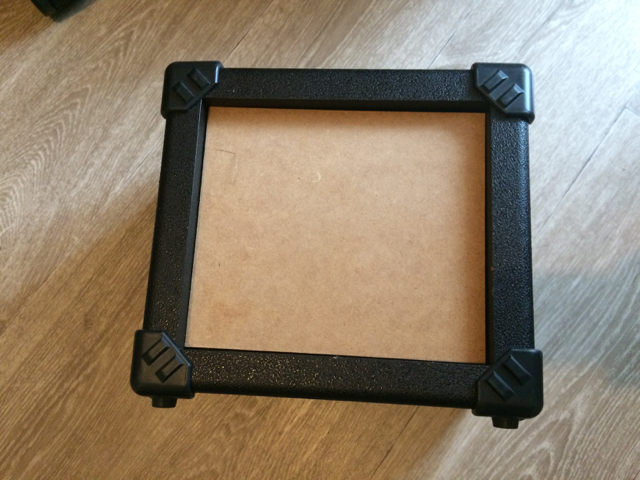

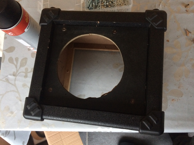

Having made a mess of the front panel for the Jensen, I got a little piece of 6mm MDF cut to 156x178mm, which is a pretty good fit.

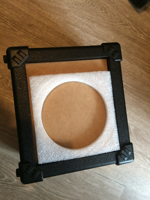

Th packaging comes with a bit of foam that happens to have a hole in that's exactly the right size for mounting the speaker, so use that as a template.

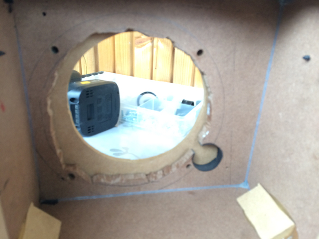

12.5cm of glorious round hole (woohoo!). I made it off-centre so as to leave space for a port if necessary.
Now you can see quite how grim the previous attempt was... You can see the original port, which I did not keep or replicate.
I sprayed it black, then glued and screwed it into place:

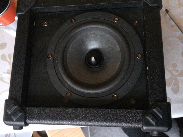

and then drilled pilot holes and mounted the new speaker with wood screws - the 6mm MDF is not thick enough to use the original bolt mountings. I coloured in the screw heads with a black sharpie to keep it low-key. The extra panel means that the speaker is 6mm further forward than the original, but there's enough of a rebate for the grille to still fit in front of it.
So how does it sound? Well, much better than the Jensen - all the top end is there. There's definitely more low end and I can now play the "black panel" model without it sounding flappy. The "classic stack" model seems a bit warmer - though of course I can't A/B it now.
As for cost, well to let you in on a secret, I only paid €30 for the amp at a local car boot, and the speaker cost me €58 delivered from Audiophonics here in France, so the whole thing has not cost me much at all, and I'm very happy with the results. Overall I definitely recommend the Dayton over the Jensen - it's a better fit, retains the top end, and sounds better than the original.
