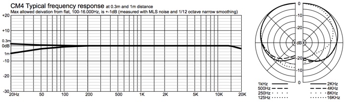

Let's compare....
CM3
CM4
Although the front ±90º are the same for both - the CM4 has an obvious much better rear attenuation.
The CM3 is definitely a wide cardioid - the CM4, although not an absolutely true cardioid, is much closer. I think Schoeps term this as an "open cardioid".
They may sound the same, but the difference in the rear pick-up should be noticeable.

So not great at understanding the graphs but the flat graph suggests to me the CM4 will pick up more bottom end including low rumbles if one is not in a well insulated studio, than the CM3?
I’m trying to understand the circular graphs, the degrees and db’s. 180 would be the back of the mic? Zero the front? Why is one graph showing -20 and the other zero db? Shouldn’t both graphs show either zero or -20 for the same frequencies in order to compare them? Is one of the circular graphs upside down to the other? (Mic front on the bottom in one, mic front on the top in the other?)
Sorry, these things don’t seem to work with my brain.

One polar plot is inverted with respect to the other. No idea why, but it is.
And the CM4, being more cardioid-like, does have a higher degree of proximity boost at low frequencies compared to the CM3, though the actual difference is about 3dB at 20Hz at 30cm, and almost nothing at 30 Hz. And at 1m, the bass drop-off is about 2dB less by 20Hz.
Also don't forget that these responses are almost certainly slightly idealised by 1/3 octave smoothing, so individual mics will have more dips and peaks showing on a non-smoothed graph.
The low-end frequency response is very similar to other SDCs, e.g. a Röde NT5, so rumble pickup will be par for the course. Easy enough to HPF the recording afterwards - and this gives more creative freedom than having a fixed HPF switch on the mic itself. Even live, unless you are using a basic small desk with no HPF available, it shouldn't really be an issue - at least no more than any other SDC.
And the more cardioid-like pattern means that the CM4 can be positioned to reject more unwanted sound than the CM3 could.

Edited to add: Oops -- just seen that Wonks has said exactly the same ahead of me!
What it's showing is that two mics have a very similar response for sources at 1m distance, but the new CM4 has more proximity effect -- hence the raised low-end response for sources at 0.3m. This is entirely to be expected and tallies with its more directional polar-pattern -- the greater proportion of pressure-gradient (velocity) operation, the more the pattern tends towards fig-8 and the stronger the proximity effect.
Correct.
Yes, the CM3 polar plot is shown upside down with the business end of the mic (0 degrees) facing downwards. Here are the same charts, but with the CM3 polar plot the right way up for easier comparison:
ManFromGlass wrote:...the flat graph suggests to me the CM4 will pick up more bottom end including low rumbles if one is not in a well insulated studio, than the CM3?
Correct.
