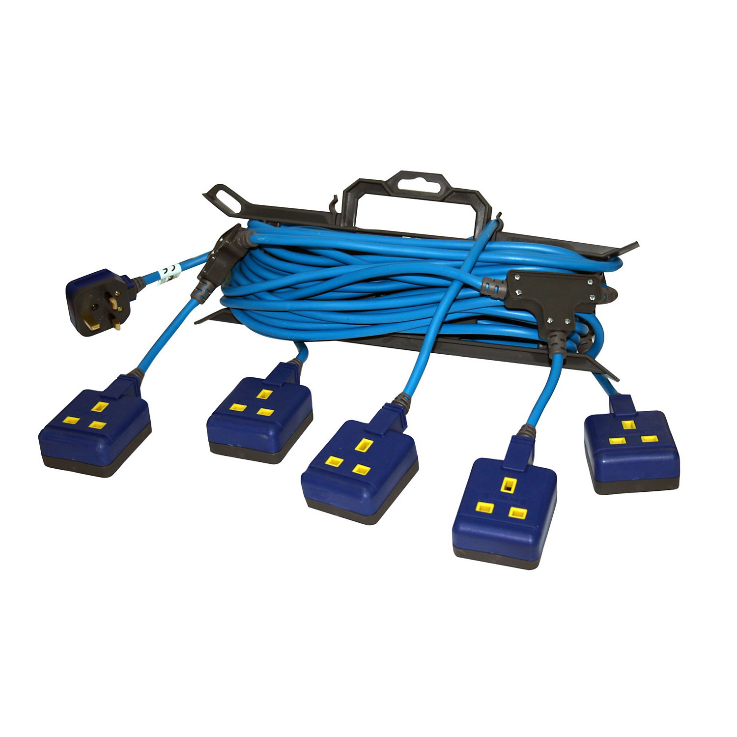

Postby Sam Spoons » Mon Jul 29, 2019 10:24 am
I inherited a couple when I took over PA for a now defunct band but I find them heavy and difficult to coil so don't use them. Obviously YMMV. What I do use (which is also heavy and difficult to coil :oops: ) is a couple of these https://www.diy.com/departments/masterplug-5-socket-13-a-extension-lead-15-m-blue/244075_BQ.prd
