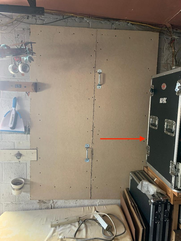

If you all can look at the attached screenshot please you will see my issue. First is what we have done which is to build a removable soundproofing apparatus with soundproofing board. Problems with this is the apparatus is around 50 pounds and also when he is removing it for when I have to be in there on weekends the right side of the apparatus is coming in contact with my cables at the back of my rack.

I think you probably have the best solution in place then (unless anybody else can come up with something better). The fabric curtain claims a max reduction of 6dB which I doubt will be anywhere near what you already have, and at $99 it sounds expensive. If it was me I'd work out a better way of fixing the panel you have so it can be installed/removed with no risk to your rack and wiring.

Sam, yes I was thinking the same exact thing, that nothing will work better than that apparatus but just checking around for a better removable option. I don't say way to use that panel since it's both the weight and size that's the issue.

TBH Mike, if he's able to work the early hours using speakers I reckon you present solution is doing a very good job. I wouldn't expect a curtain of either kind to come close but the only way to find out is to experiment. Maybe trying to measure the attenuation outside the window provided by your panel first using some music and a phone app SPL meter to see what you are trying to achieve. Then at least you'll have an idea of whether this curtains will come close.

Is the apparatus screwed into place or on hinges? If the latter then a door stop will stop it hitting your cables, if the former, is it a not enough space for storage issue i.e. is it propped up too close to your rackmount cabinets? If so then maybe cutting the panels in half vertically and joining them back together with long hinges so that they can be folded when being stored could be the solution. You’d probably need to glue some foam to the cut edges where the blade has removed some material.

Postby mikehende » Tue Apr 28, 2020 5:09 pm
Sam Spoons wrote: Maybe trying to measure the attenuation outside the window provided by your panel first using some music and a phone app SPL meter to see what you are trying to achieve. Then at least you'll have an idea of whether this curtains will come close.
#Eddy Deegan, I refrained from asking that as I have grown up, sorry, adult sons and they firmly believe they know better than us old buggers.
Great advice, I can try a phone App but immediate problem I think would be how to keep the
sound from going into the space between the wall and the window? If it would be like covering the window with material and sealing off the edges then yes but since this would need to be a removable option, not seeing how a curtain would work?'

MOF wrote:Is the apparatus screwed into place or on hinges? If the latter then a door stop will stop it hitting your cables, if the former, is it a not enough space for storage issue i.e. is it propped up too close to your rackmount cabinets? If so then maybe cutting the panels in half vertically and joining them back together with long hinges so that they can be folded when being stored could be the solution.
No the apparatus fits snug into the window which is indented into the wall. That apparatus is made of 2 sides of the soundproof board with foam spray in between. There is like 3 inches or so of space in between the wall and the window.
This pic of the outside will show what I mean:
https://i.postimg.cc/3JRzGNSN/window2.jpg

Is the reason that you need to remove the panel to allow light in? If so, have you thought about using a permanently fitted double glazed unit or a sheet of 10mm glass instead of the panel? It may also be worth replacing the outer window with something more substantial.
