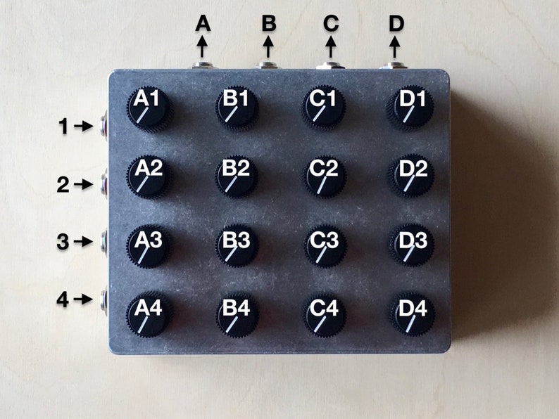

If it's for the modular, maybe a matrix mixer would suit your needs better?
Something like this Doepfer one, perhaps:
... Or like this random one...
Or if it's a couple of sources needing to go to several destinations, maybe a zone mixer like the ART MX225?

For situations requiring few inputs, but lots of outputs from those inputs -- and in a small footprint -- a simple matrix mixer will often provide a usable solution.
I gather you need to route a few input channels to at least two main outputs, along with at least two auxes... so a matrix mixer with 1>4 capability would seem to fit the bill. Much like the ones I highlighted previously.
The Zone mixer is a variation on that theme. The ART model takes two stereo inputs and routes them to five stereo outputs...
Of course, if you also require EQ on channels a matrix or zone mixer might not be what you need at all... or maybe it could be with separate hardware EQs on the sources? Who knows?
