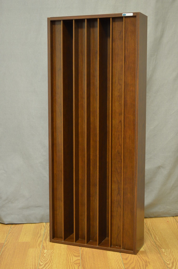

To be fair, mention 'diffusor' to most people and they will automatically think of 'skyline' quadratic diffusers -- square arrays of different size blocks:
... or finned diffusers with different size vertical slats.
Few would ever think of flat/slotted diffusers, even though they are quite widely employed.
(These all happen to be Gik products, but similar things are available from many other suppliers, or as DIY solutions)
