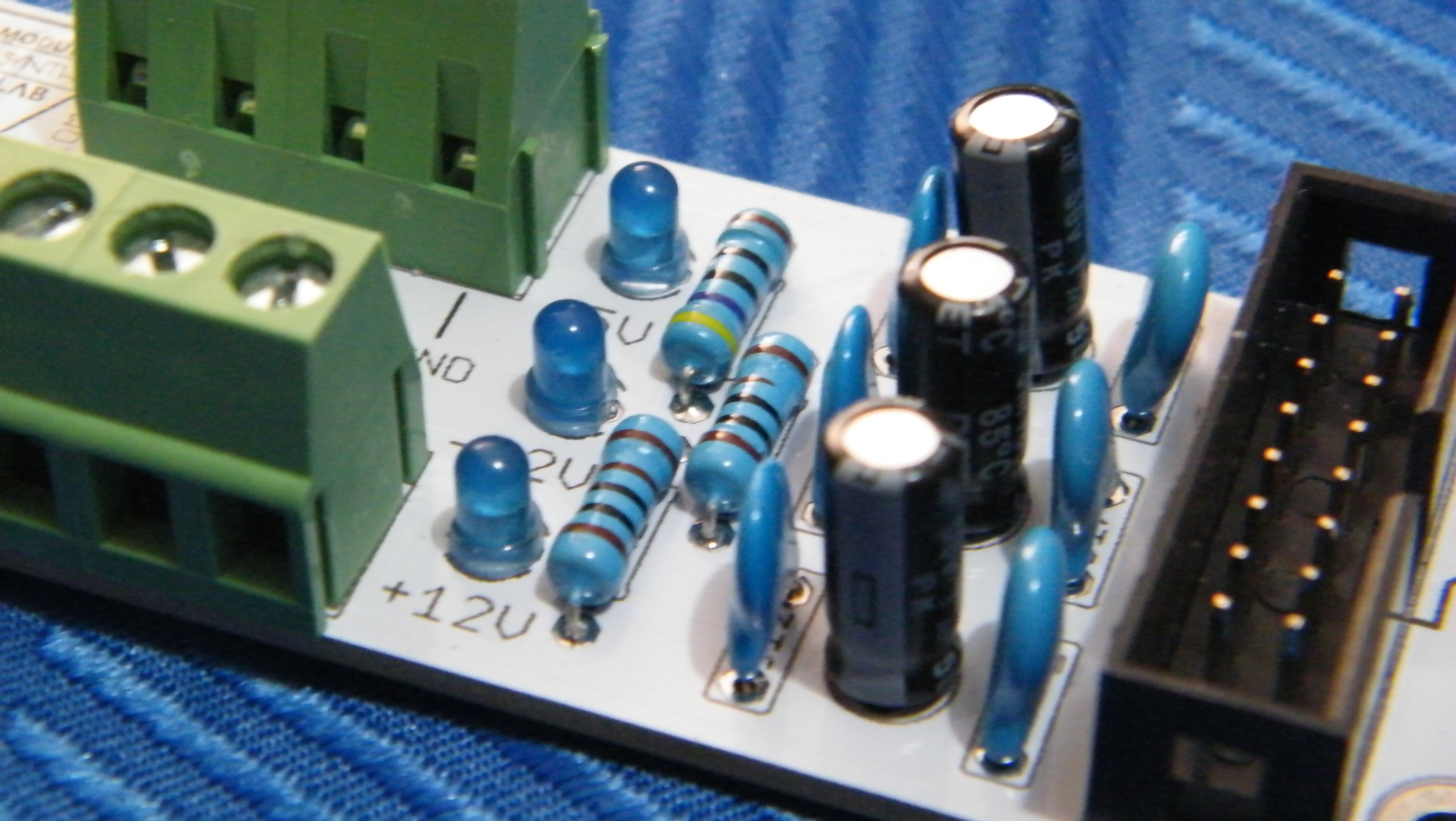

Building a big modular synthesizer. My Diary – part 5: Building the first power supply and a makeshift case only for testing..... and having a look at power busses
https://youtu.be/i3JOQmxYPXU

Postby Folderol » Sun Apr 28, 2019 10:30 am
Hmmm. You seem to have used green/Yellow wire for all the connections. This is a definite NO. That cable should only ever be used for earth/ground wiring.

Postby Dan LB » Mon Apr 29, 2019 3:38 pm
Folderol wrote:Hmmm. You seem to have used green/Yellow wire for all the connections. This is a definite NO. That cable should only ever be used for earth/ground wiring.
This ^^^
NEVER USE GREEN/YELLOW WIRE FOR LIVE OR NEUTRAL CONNECTIONS!
