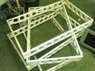

Postby Helmutcrab » Tue Feb 05, 2013 4:26 pm
Thanks for the help so far fellas. This is an update.
As you know i was wondering how to stop the insulation from sagging long term for ceiling and wall-ceiling panels. I found a thread where fiberglass joint mesh tape was used. I used superglue and Duck tape ( apparently superglue only works when oxygen isn't present ). I pulled on the tape once glued to one side to check its hold and it was very strong.
The problem was when i tensioned the mesh it pulled the thin frame in quite a lot and this prevented me from getting the same tension on both mesh strips ( unless i measured exactly the pull in for both - too fiddly ). The other problem is it would bring in the centre of the frame too much, causing compression of the insulation. I then realised the tape strips could be added on the outside of the frame once finished and the side supports would increase rigidity to some extent. However, Ethan Winer mentioned small wood cross braces ( up to one inch ) in the central field of the panels are not a problem even in the RFZ. This is reassuring to know especially for the overhead panels.
My next problem was how to hang the metal frames. I found D-rings with 4 mm holes which i could use with 4 mm pan bolts, nuts and washers from www.ukpictureframingsupplies.co.uk . I got hanging cord from there too.
The pan bolt would go inside the frame ( with the washer ) and would avoid any internal intrusions to the insulation. The next problem was where to put the D-rings, as unlike wood frames the possition of these need to be set before the panels are riveted shut. The only way i could think of was to put one on the outer side ( in the middle ) on each side corner thereby using only two D-rings as support. This would enable the panels to be turned around ( if reflections are required ). However, this only allows the panels to be hung from the ceiling horizontally and not from the walls ( walls here are made wrong and not weight bearing ). It also does not allow them to be used vertically ( either hung from wall or ceiling ). The only way to allow for more hanging options ( should i ever move house and wish to hang from wall ) would be to use 4 D-rings on both sides of the panel ( at 20 % in from the top and bottom in vertical plane ). This method would have to be used on wall - ceiling panels anyway but having to do it on wall only panels is more work and would mean when hanging them from ceiling horizontally they would have cord on an angle which may have to wrap around the wall - ceiling panels above them in order to get to the available joists.
The metal frames take a full working day to structurally complete ( before insulation and final rivets are added ). This, combined with the problems of hanging, the pulling in from tensioning the mesh and having to attach fabric with glue made me try to make a wood panel to see if it was easier and quicker. Once one metal and one wood panel are finished and hung i can decide which type to use. By the way, total costs are very similar for both except for the purchase of rivet gun and tin snips for the metal panels. However, I do already have a power drill and screw driver.
I have to thank my local timber yard www.arbortimber.co.uk who came up with the following design after i explained my needs.
Dressed 2 x 1" timber is used for this. After dressing, dimensions are approx. 20 mm x 45 mm. In order to get a good right angle cut and not take forever, i got the timber yard to cut the wood @: 4 x 1240 mm , 4 x 600 mm, 8 x 60 mm. Due to tolerance whilst cutting the actual lengths were: 1238.5, 58.5 and exactly 60 mm. This last one i was very pleased about as it had to be exact to maintain panel and insulation depth. The other lengths would allow for a small amount of compression to hold the insulation in place.
As you can see four independent frames were made. Each one using only two 70 mm screws either side to attach the 60 mm corner pieces. Plenty of wood glue was used on both adjoining surfaces ( i had 4 failures from only using on one surface initially ).
I tried some hand clamps to hold the pieces in place but they were not strong enough so i used my dad's hands instead who was helping me for the day !
Next i had to glue and screw one short and one long frame together in a right angle. I bought a corner clamp for £2.99 but when i checked it was indeed a right angle with my metal square i found it was off.
And then it broke !
I also bought different metal drill bits ( both normal and titanium ) from the same manufacturer which made this cheap clamp. Unlike the clamp here, the drill bits were not much less than good brand competitors and every single one snapped within a few goes. This is very dangerous and non of these products are fit for purpose. I won't name and shame but suffice to say if you stick to Dewalt and Bosch you won't go wrong with drill bits.
I then had to come up with another way of getting a right angle. I do not have a work bench so am using the dining room table with another old table top on top of it. My dad was a carpenter many moons ago and had the idea of screwing a long thin mdf panel to the table top at both ends - checking it had a true right angle first :
I then screwed a small piece of wood at exactly 60 mm down from and at a right angle to the top of the mdf :
I then made sure the two frames joined at a right angle :
Marked the wood to indicate the width i have available to screw into :
Then i marked the position the screws ( 50 mm ) would go into. Six screws are used to secure each corner. From the markings you can see that each piece of wood will have 2 screws in it. One on the outer side and one on the inner side. This is very important as these 50 mm screws have to go past the sides of the 70 mm screws ( making the individual frames ) that are perpendicular to them, otherwise they would run into the 70 mm screws and not bed fully. This makes the frame corners strong and negates the use of supports thereby allowing the insulation to fit properly without needing to be cut or compressed. Remember to number the frames ( 2 and 2 on the top in this case ) in case you don't get time to screw them together.
Next apply plenty of wood glue to BOTH adjoining frames.
Then counter sink and drill using a 3 mm drill bit and power drill through the first piece of wood and slightly into the second so the 50 mm screws can get a hold and without splitting the wood.
Next screw in the screws :
Once i had joined two corners together i had two L shaped frames. I positioned these together :
In order to get the full frame length level on the table i had to use wood and wedge supports at the other end :
This time however i stopped once i had drilled holes as the intention was to put the two L shaped frames around the insulation, then glue and screw to finish it. This would allow me to not disturb the insulation by pushing it down into a finished frame. However i may just do that as it will be difficult to work outside without a solid bench/table and i want to maximise my time outside when i do eventually get a good day.
It is still snowing and is now very windy but as soon as i can get outside i will pva spry the insulation, glue the paper to it and fit it in both metal and wood frames.
Here's hoping for a good day soon !

Postby Helmutcrab » Wed Feb 06, 2013 4:20 pm
Hi James,
That looks like a great studio. You don't seem to have used any face support for the panels - even the ones on the ceiling ? Thats reassuring.
What density rockwool were you using please ?
Fruitfarmer and co. ,
Ive finished my first wood panel and added insulation - it was so windy the insulation blew away - thats the North East of England for you. You can't have it sunny without the wind. I gave up on waiting for a good day - it may never come !.
I added the insulation after i had made the frame. This was the worst way to do it as it got compressed and damaged at the sides where i had to use a scraper to get it in and was impossible to get the 50 mm slab to sit just right . Still its a usable frame.
Ive now learned you need to finish the panel with screws but then take the screws out of the last two corners and put the two L shaped frames around the pva sprayed insulation then glue and re-screw the last corners.
Im very happy with how the wood works so i will be using only wood panels.
After making the wood frame i realised the metal frames just don't have enough support to prevent the insulation from being handled whist moving them around. There is a 1" lip all around the sides of the wood panels that can be handled and protects the insulation.
So, ive scrapped the metal panel idea - they would work but just not as well as the wood. They take a couple of hours longer to build and changing hanging options are not available once sealed. Getting the final rivets in would have disturbed the insulation too much also. This became obvious after handling the insulation - i forgot just how fragile it was.
Also, i think i will be spraying a 1 : 20 PVA glue solution twice (before and after panel completion ) for the rest of the panels instead of 1: 10. 1 :10 just seemed to release too many thick patches.
Im bulk ordering the wood today for the rest of the 24 panels and will report back once ive got some finished.
Cheers
Peter

Postby thefruitfarmer » Thu Feb 07, 2013 2:25 am
You can add a drop of washing up liquid to the PVA solution, it makes it work better ( I forget exactly why but if you search the stickys the reason will be there )...
I should not worry too much about thick patches on the mineral wool slabs, it is all going to be covered anyway and it will serve the purpose of keeping the fibres contained...however, if you DO find one coating of 1:20 and a second coating of 1:20 PVA works easily to get an even covering then you might have found a good trick....
Pity about your corner clamp. I paid about £15 for a pair of them and they made the job so much easier.
Will you soon be in a position to mount the completed traps and have a listen before building the remainder?

Postby Helmutcrab » Thu Feb 07, 2013 9:17 am
Cheers thefruitfarmer,
I added a few drops of washing up liquid but still seemed a bit thick.
I think i will be fitting the panels straight into their place once made. I need to get some material covering now.
Can i ask you exactly what dimensions you used for the wood to compression fit around the insulation ?
I used 2 mm off the 1240 x 600 mm ( 1238 x 598 ) because thats what the wood measured after it was cut, but it was a little warped on one side so it ended up being 4 mm down in the centre. It all seemed a bit tight but i think that was because i pushed the insulation into the double frame instead of finishing the panel around it.
Much Obliged,
Peter

Postby thefruitfarmer » Thu Feb 07, 2013 10:47 am
How are you applying the PVA/washing up liquid? I used a cheap plant sprayer and the 1:10 solution was as thick as milk. So long as it goes through the spray nozzle and dries to a crust it will be fine.
I would get the finished panels up ASAP. Then you will be able to assess the effect they have, move them about a bit and then work out how many more you will need.
I did not actually compression fit around the insulation. I just built the frame to have internal dimensions of the Rockwool slab, fitted chicken wire to the front face and then dropped the slab in place. It was at this point I sprayed the slab with the PVA solution, let it dry and then covered it with fabric.
The slab was a snug fit, but with the 60kg per m3 rockwool there is enough give for it to not be a problem.
The compression fitting is not essential. So long as the air can vibrate the fibres in the mineral wool, thus converting the sound energy in to (a small amount of) heat then the trap is doing its job. However, the compression fitting would probably give you a better finish.
